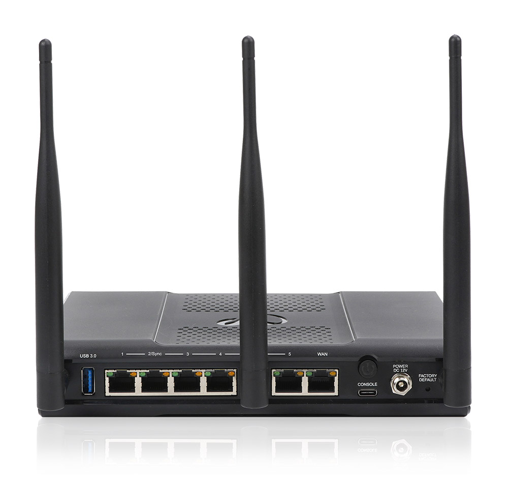

1530 / 1550 Security Gateway
  • Wired and WiFi flavors.
  • 5x1GbE LAN, 1x1GbE WAN.
  • New look and feel, slim fanless design, plastic based.
  • Front panel LEDs indication (4 LEDs).
  • Power button.
  • Dual band non-concurrent 3x3 WiFi.
  • USB Type-C console port.
  • USB 3.0 Port.
  • NGTX performance - 450 Mbps (CPEnt).

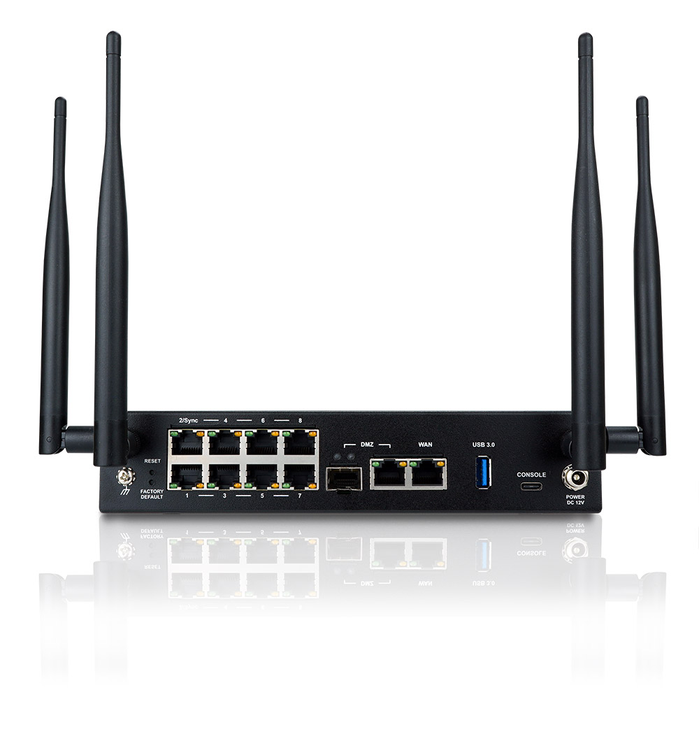

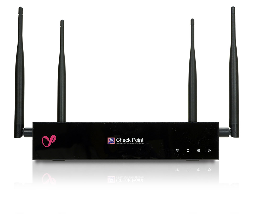

1570 / 1590 Security Gateway
  • Wired WiFi and WiFi+LTE (New!) flavors (see description below).
  • 8x1GbE LAN, 1x1GbE WAN ports, 1x1GbE / SFP DMZ ports.
  • Dual band concurrent 802.11ac wave II 4x4 WiFi (see below for 1570 / 1590 Enhanced WiFi capabilities).
  • New look and feel, lightweight, fanless, Aluminum-based design.
  • Front panel LEDs indication (4/5 LEDs).
  • USB 3.0 Port.
  • SD Card support.
  • Dual SIM (Nano and Micro).
  • NGTX performance - 660 Mbps (CPEnt).
