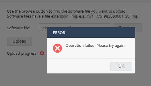

Symptoms
Manual upgrade from R77.20.80 or older images to a higher firmware version might fail due to a timeout on SMB Appliances. The failure occurs in the upload process after a manual upgrade from the WebUI is started (Device -> System Operations -> Manual Upgrade):
